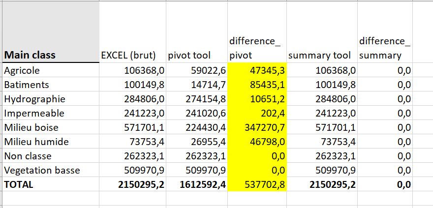

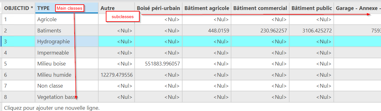

I'm running into a weird issue. I'm trying to use the pivot table tool to summarize data from a feature class. The idea is to have main class as rows and subclasses as column and get area total at intersection.

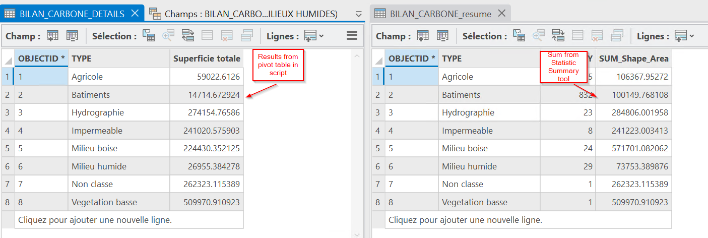

Then, I use a cursor to sum all subclasses value into a new total main class column.
While trying to validate the cursor coding results, I noticed that I didn't get the same total values
I have exported my raw data to excel and tried to figure out what the problem is and from what I get, the pivot tool does not calculate correctly the area sums (or at least not for all classes??).
Does anyone have an idea about what causes this? There is no selection or subfiltrer on the input data to pivot table.

I'm not certain that Pivot Table is the tool you should be using. I recently used it in a project and don't recall there being any summary operation. Pivot Table can be used to turn rows in a table into columns. Say, for example, you wanted to turn (or pivot) each of your main classes into columns.
Can you try and explain, in another way, what type of summary you are trying to accomplish? Maybe there is a more appropriate tool like Summary Statistics or Calculate Field.
