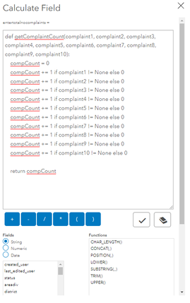

Hi @Anonymous User, I'm thinking this isn't exactly a SQL question with a "def" statement. I think that's a Python function. You could use something like this as a field calculate function:
def getComplaintCount(complaint1, complaint2, complaint3, complaint4, complaint5, complaint6, complaint7, complaint8, complaint9, complaint10):
    compCount = 0
    compCount += 1 if complaint1 != None else 0
    compCount += 1 if complaint2 != None else 0
    compCount += 1 if complaint3 != None else 0
    compCount += 1 if complaint4 != None else 0
    compCount += 1 if complaint5 != None else 0
    compCount += 1 if complaint6 != None else 0
    compCount += 1 if complaint7 != None else 0
    compCount += 1 if complaint8 != None else 0
    compCount += 1 if complaint9 != None else 0
    compCount += 1 if complaint10 != None else 0
    return compCount
This simply checks if each value is null and adds 1 to the compCount variable if it is not null. If your complaint fields are not nullable strings, you'd want to replace the "None" with a ''.

Hello, this makes sense. I added this to the calculate field, but I get calculate expression is not valid.
I do see a functions field and count function is not in it. I wonder if this calculate field only performs the functions in this list?
Thank you Doug!
