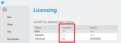

Hello @KeshavSingh1 , what License level are you using in ArcGIS Pro ?
KeshavSingh1
Oh I have Basic License. But I remember I have used paste special before.
