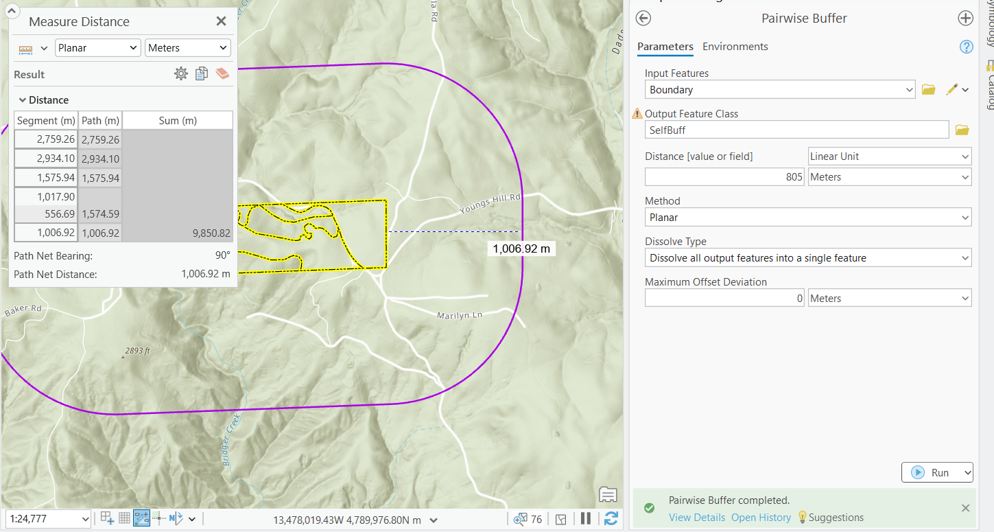

I've noticed a slight discrepancy in one of my processes while using the buffer tool in ArcGIS Pro.
In short - I'm putting in a specific number as the buffer distance, but after measuring it, both in Map and Layout view, the distances don't match.
I've attached a screenshot - any help is appreciated.
Thank you
StevenSGIS
Solution - Coordinate system was wrong... I don't know why it changed, but now I know I'll have to double check my project files now... (all of them)
