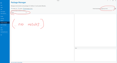

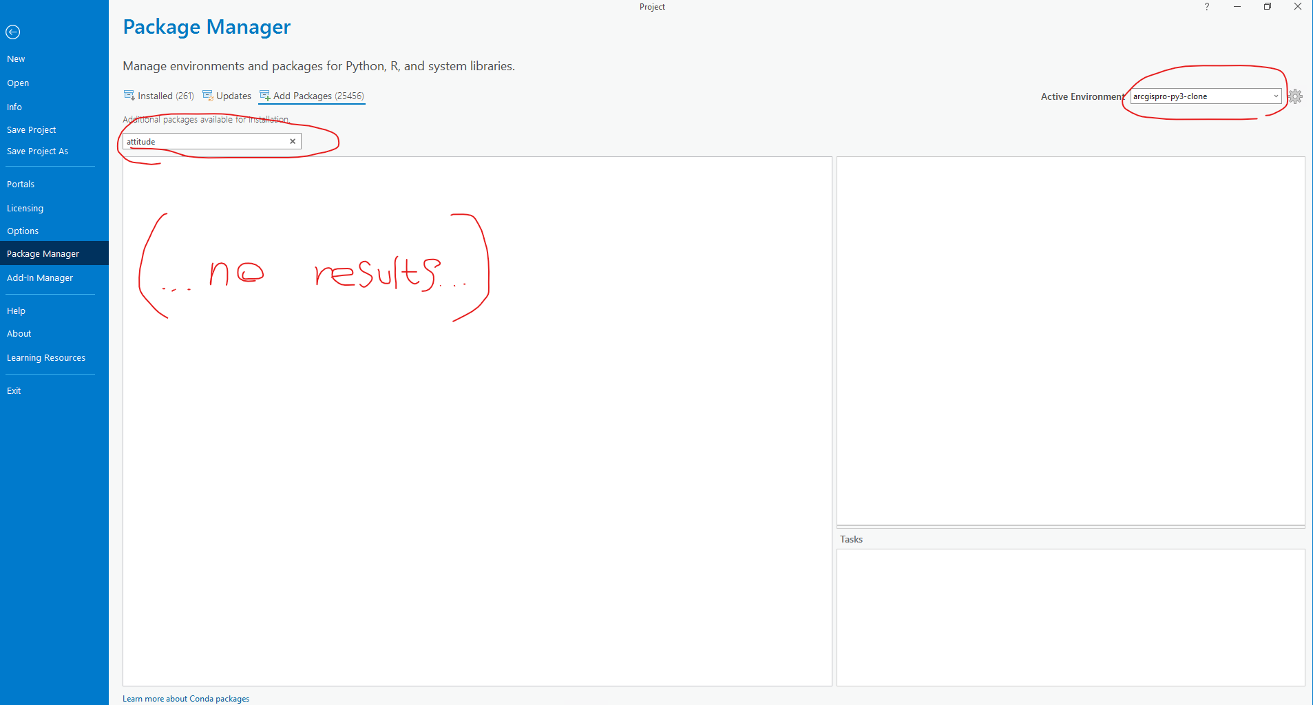

I am currently running ArcGIS Pro 3.3.0 on Windows 10. I am attempting to install a third party package to the Package Manager (https://davenquinn.com/projects/attitude/). I am inside of a cloned environment for my Active Environment. This third party package is not listed under the ""Add Packages" option and I am unsure of how to add this package to that list.

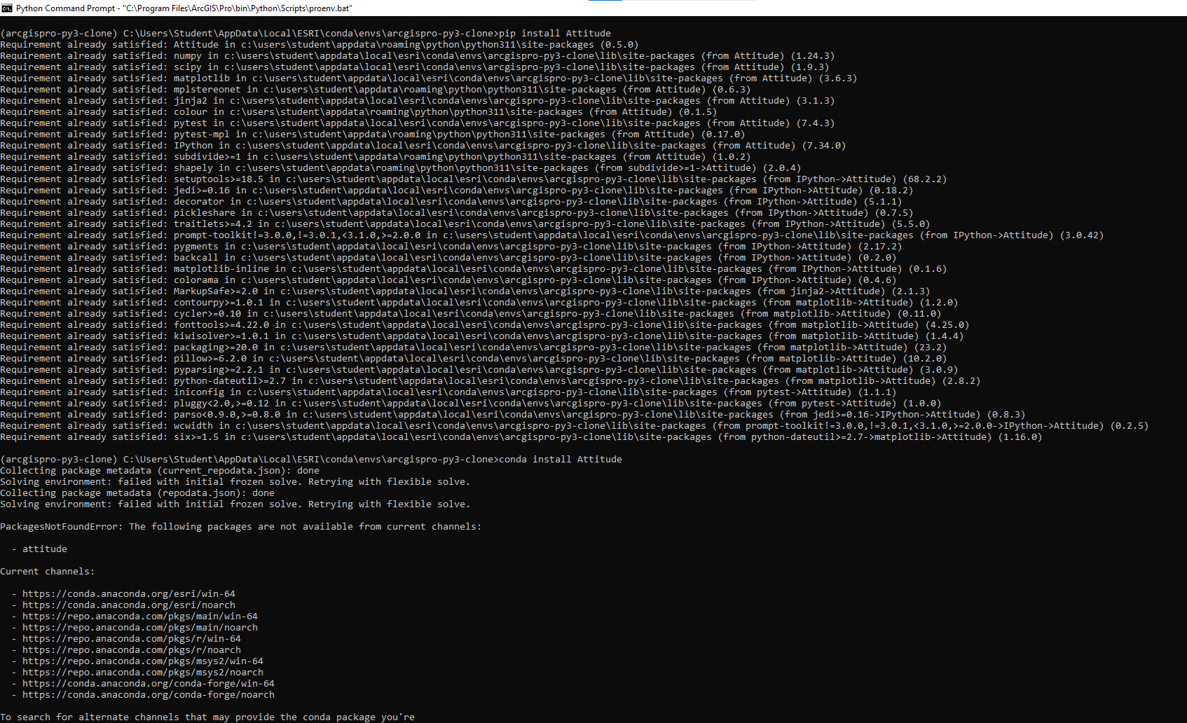

When I open the Python Command Prompt I enter the command "pip install Attitude" (as per the third party installation directions in the link provided above). When the command is run, I get a "PackagesNotFoundError" for "attitude":

If pip doesn't work then something is wrong with this page as well
Attitude · PyPI
you could try installing it from the downloaded files on the above site or contact the author, but it appears that it was last updated in 2019 and his last post on his github site was from 2022
davenquinn/Attitude: Attitude is for fitting the orientation of planes! (github.com)
you could probably download the code from there if you are comfortable checking it for python dependencies
good luck

Hello DanPatterson! Thank you for the response. I tried that command and get the "PackagesNotFound" error and I have tried entering the "pip install Attitude" command in the Python Command Prompt.
My problem is that I do not know what next step to take in order to further troubleshoot. Would this be a question best directed to the author of the software itself? I appreciate all help...

Just a side note, the version of Python has been upgraded to 3.11 with ArcPro 3.3. and if as Dan hints there has been little maintenance in that module you may find it won't even work?
