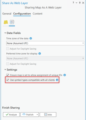

If you want to still use Classic Map Viewer, you can check the Use symbol types compatible with all clients option when configuring web feature layers. This option was added in ArcGIS Pro 3.1 and enabling it converts ArcGIS Pro symbols to web symbols that can be rendered by most older applications. JonahLay_0-1683239849647.png
Please see the following help topic for more info: https://pro.arcgis.com/en/pro-app/latest/help/sharing/overview/configure-web-feature-layer.htm
