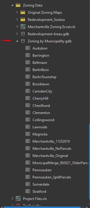

The existing Zoning data that we have is only for 17 out of 37 municipalities. When I was creating this data, I clipped each of those 17 municipal Parcels to their municipal boundaries and modified the data. So I now have a .gdb with individual Feature Classes that hold the OLD parcels.
So my long-winded question is: Is there any way to take the new Parcel data (which is the entire county) and overwrite the existing Feature classes (municipal)? Or do I need to re-clip all new Feature Classes? What is the best way to go about this?

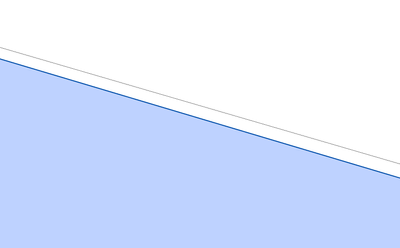

When using Clip, if your zone boundaries do not exactly match your municipality boundary, then a portion of that feature may be clipped off.
For example; The blue area is my city limit. The thin black line is a parcel outline. You can see that if I clipped based on my city limit boundary that a sliver of the parcel will be excluded. Paul_Christensen_1-1632405140512.png
