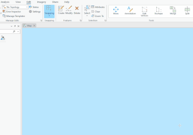

Try setting it here: Units > Direction Units > Direction Base Units > Direction Formatting Dialog > Direction Base Unit drop-down. Hint, within the Direction units table, double-click on the example value in the format column to get to the Direction Formatting Dialog. Or just watch this gif:
