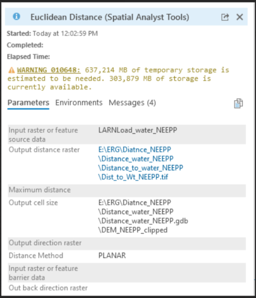

Good morning everyone,
I am trying to use the Euclidean distance and Distance accumulation tools, but every time I try running this it looks like it is working but after hours of running I get the following warning message: "100648: 637,214 MB of temporary storage is estimated to be needed. 303,879 MB of storage is currently available" (see image below).
Any guidance to solve this issue is greatly appreciated.
I am using ArcGIS Pro 3.3.1.
My computer has 2 SSD drives, on is 500GB the other one is 4 TB. I have 120GB of RAM.

Your E drive... is it the one with most storage?
Use the environments tab to specify where scratch data is to be directed, that is the one that needs to have space for temporary data.
