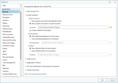

But I suppose my .aprx ArcGIS Pro projects are still being saved to OneDrive. I didn't realize that until now -- I'd only changed the location of my geodatabases, not projects. So I'll change the default project path to a folder on my C drive too.
Note: I haven't been able to figure out how to disable OneDrive syncing. The Microsoft docs seem to be outdated and talk about settings/pages that no longer exist.
Edit: I don't think my OneDrive account was properly linked before. That's why I couldn't find the setting to unlink it, even though my files were being synced (I know they were being synced because I could see them in OneDrive web). But I managed to solve that issue by opening the OneDrive app via a web link, properly setting up/linking OneDrive, then unlinking it via the OneDrive settings in Windows Explorer.
Ugh. I find all this Microsoft OneDrive stuff very messy.
We'll see if saving my ArcGIS Pro projects in a folder on my C drive and unlinking OneDrive has any effect.
