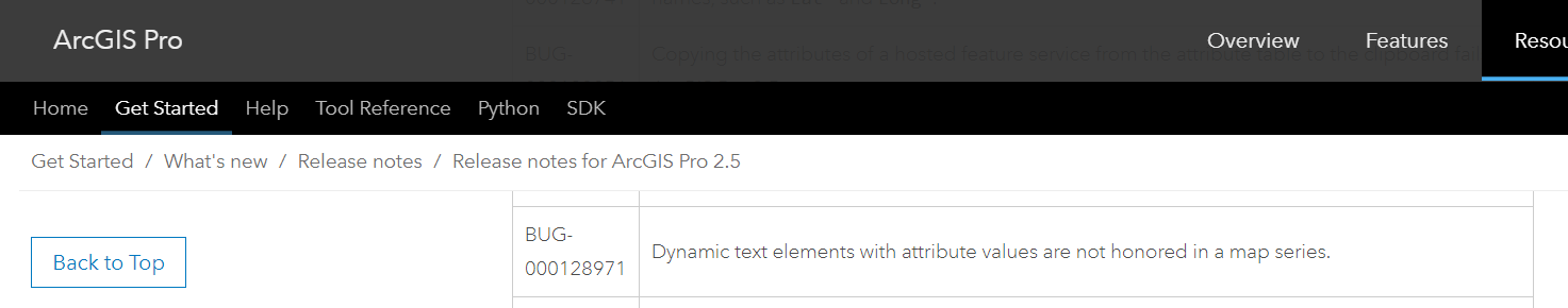

This is a known issue - BUG-000128971. We are currently working on a fix for this issue.
Tom

The fix for this issue has been included in Patch 1 for version 2.5.
ArcGIS Pro 2.5 Patch 1 is Available
