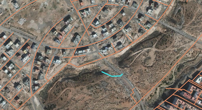

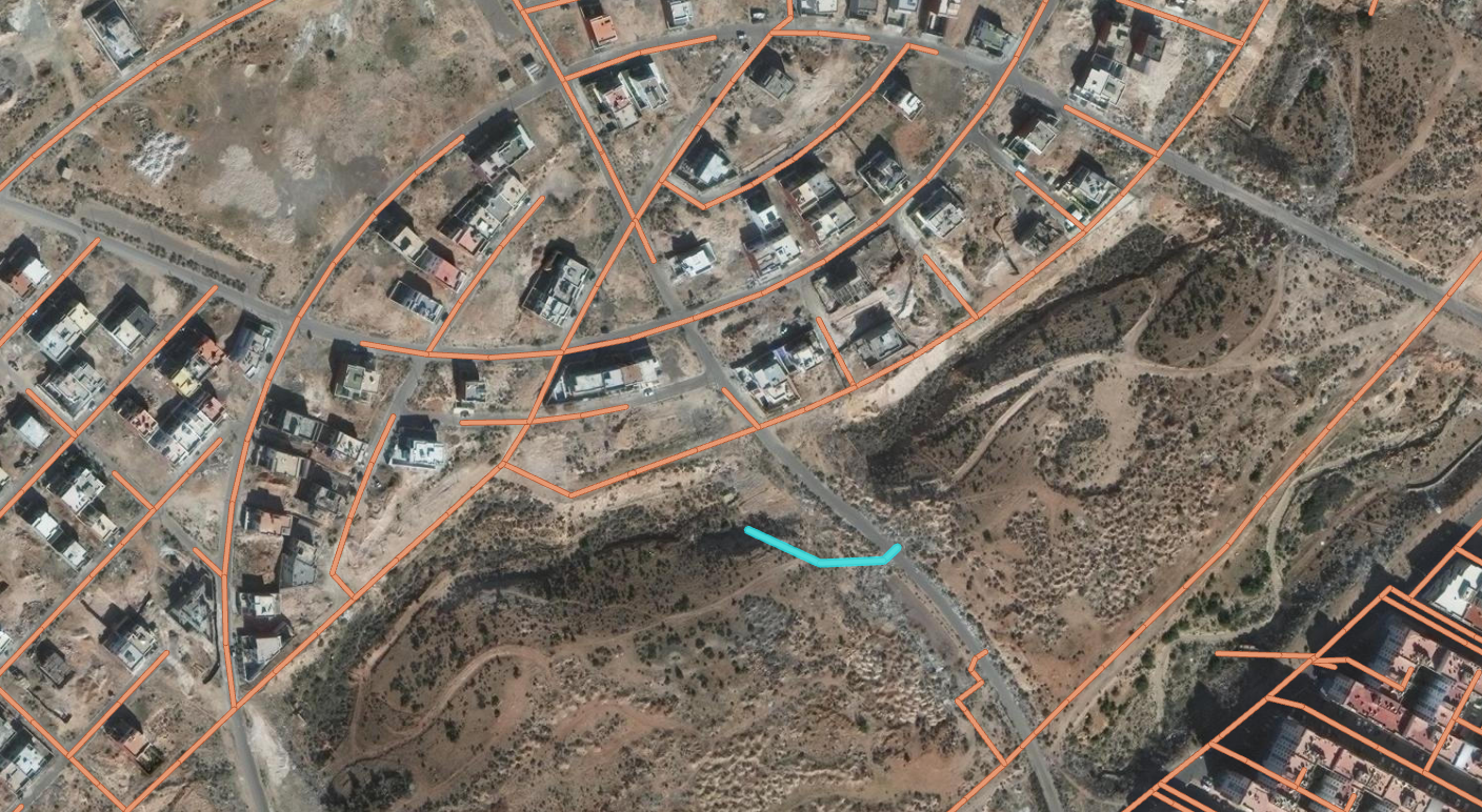

I have a vector file of lines that present a drinking water network, the objective is to correct the topographical errors of this network to have connectivity between all the lines, mainly I want to detect the isolated lines (  line Must not have two dangles ) of the network and then correct them, what is the tool that allows me to do this?
the photo shows an example of an isolated line (blue one)

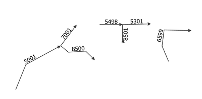

This problem intrigued me.  Here's one method to identify lines with two dangles.  A screenshot of my test data is below.  The lines are labeled with an attribute named iso_id.  The line feature class is LineNetwork. Note that every line has a unique iso_id.  For this process, all you really need is some sort of unique id.  Obviously, OBJECTID would work here but believe me, this process will get confusing if you use the object id.  If you don't have a unique id, just add one and calculate it to OBJECTID + <some value>
First step is to run the Features Vertices To Points tool with LineNetwork as the input, J_LineNetwork ("J" for Junction) as the output point feature class, and "Both start and end vertex" as the Point Type.  This gives you a point feature class of the endpoints of each line.  The output will have identical points -- for example, there'll be 3 points where 5001,7001, and 8500 meet and you want to get rid of them. So, run the Delete Identical tool to get rid of the duplicates. Choose "Shape" for the Field(s) parameter. Now you have a single point where lines meet. I call these points "junctions".

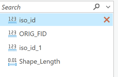

  1. Click Edit
  2. Remove all the fields on the left by selecting them and deleting with the red X

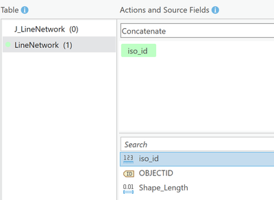

  3. Add an Empty Field.  By default, the field is named NewField , a text field 255 in length.  You can change it if you want, but keep it text and 255 long.

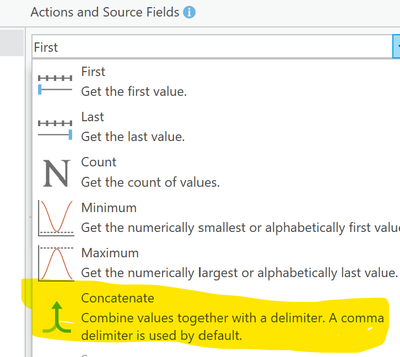

  4. For Action, chose Concatenate
  5. Select LineNetwork for Table
  6. Select iso_id for the Field.  The dialog should look like this:

  8. Join_Count is the number of lines connected to the junction (sometimes called 'valence' or 'degree') and NewField is a list of the lines (by iso_id) that connect to that junction.  Note iso_id 6599 - it is made up of two dangles - junctions with only one line connected to it.  Other records where Join_Count = 1 have dangling junctions but are connected to other non-dangling junctions.  For example, iso_id 5001 appears in records 1 and 5.  TARGET_FID is the object id of J_LineNetwork.

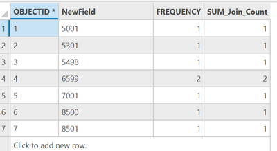

Here's the output of Summary Statistics:
Any record with a FREQUENCY/SUM_Join_Count = 2 (iso_id 6599) is a line with two dangles.  Any record with join count of 1 is a line with a dangle at one end. You can relate this table to the LineNetwork layer (NewField and iso_id are your join attributes), copy over the count, then use the count to select your two-dangle lines.
