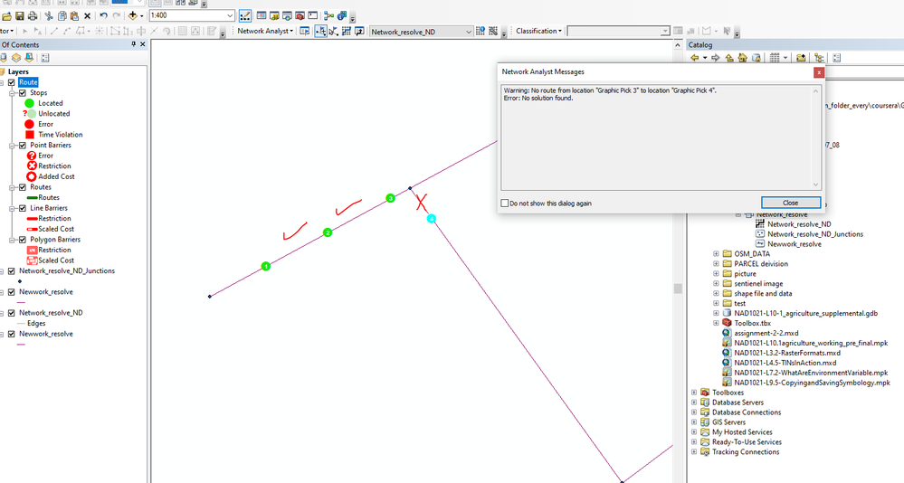

my problem is when I create new route analysis and "pick point from to" it's give me this error when I try to solve it "Warning: No route from location "Graphic Pick 3" to location "Graphic Pick 4".
Error: No solution found."
Note very important :
1)analyzing work correctly if you work in one line but if try to solve direction betwen 2 pts have different line it's give error
2)error is not from one way direction

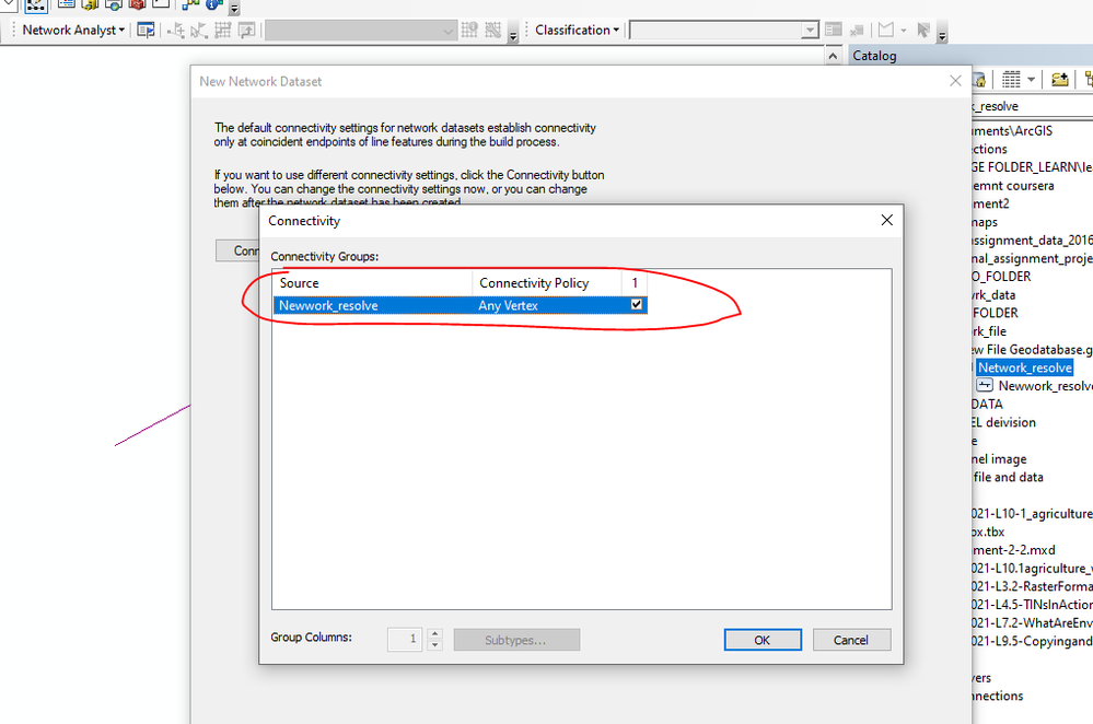

Mohamad - one thing I saw on the "internals" to resolve a similar customer call was to recreate the network with the connectivity policy of the line layers as "any vertex" and apply the workflow again.  Does the error persist?
MohamadJouni
thank you for your'e help but still don't work here the procedure I follow

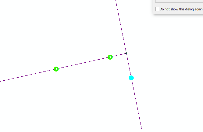

MohamadJouni
Edit: it seems it gives this only if I have a line connected to another line like shown in the picture below but if I have 2 lines consecutive it work correctly
