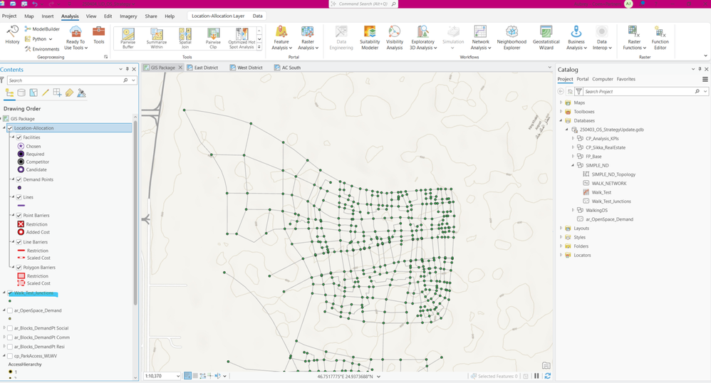

  1. Created and validated topology for all intersections & rebuilt the network.
  2. All dangles were fixed, all intersections are identified with network junctions (see below)
  3. No build errors were identified or "dirty areas" identified
ND Routes & JunctionsND Routes & Junctions

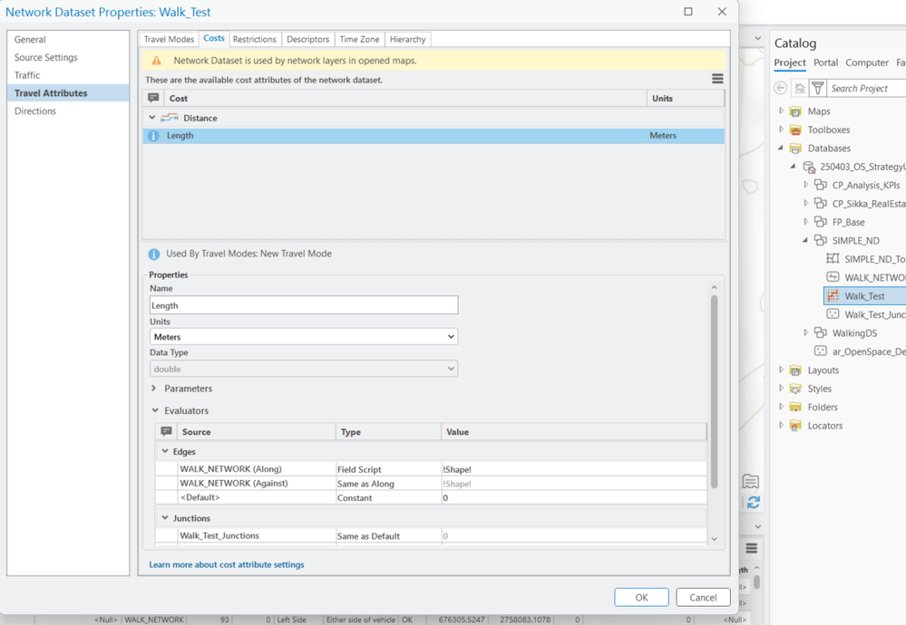

Just walking through the facility & demand input. I originally had a walk travel mode and had a time cost, same error was occurring so I simplified the network dataset to basically defaults and used meters to calc time.

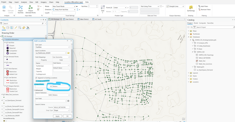

The farthest distance a centroid point I was utilizing for the demand points would be from the network was 35m. I've set to 50 to ensure it can snap to something in the network
Import Facility Location SettingsImport Facility Location Settings

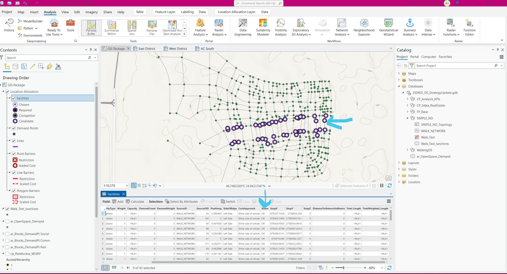

In the attribute table, the facility points all have status as ok, all snapX snapY are filled out. Everything looks as if it's reading. No errors saying can not locate.
Facility AttributesFacility Attributes

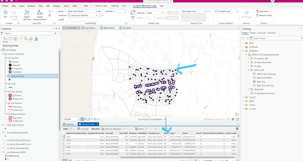

Same process for the demand points. No weights, nothing that might have null fields. Same situation as facilities, no errors, status is ok, etc
Demand Point attributesDemand Point attributes

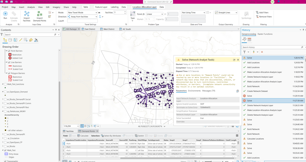

This is the error that appears when I solve. As you can see, most of the demand points are completely ignored.
Error MessageError Message
