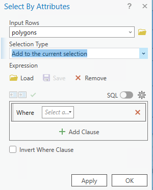

Use Select by Attributes on layer A again:
  1. Add the query used to select the 'b' features to create a new selection.
  2. Next, keeping those features selected, change Selection Type to Add to the current selection, and add the query that selects the 'c' features. At this point all the b and c features are selected.JesseWickizer_0-1682018304160.png
  3. Finally, change Selection Type to Switch the current selection which will select all the features that do not match query for b and c features. Export the selected features to a new 'd' layer. JesseWickizer_1-1682018324697.png
