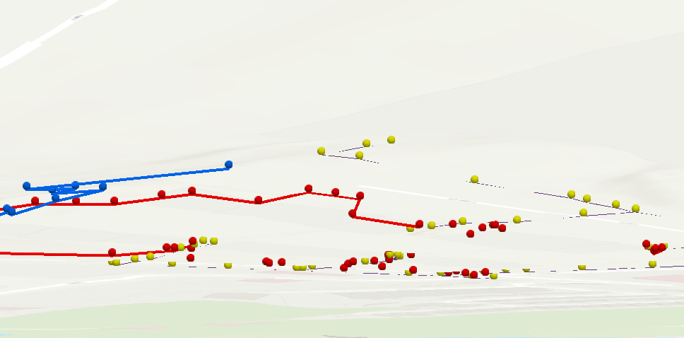

Here is my very sad attempt with a small collection of utility lines:
 Please help my poor self. Thank you.

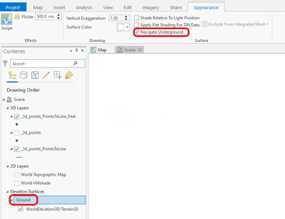

If you have points and lines that are moving around drastically as you pan and tilt, it's probably becuase they are some distance below the terrain surface and you haven't enabled underground navigation in your settings:
a) highlight the Ground group later of your elevation surface, and then select Navigate Underground in the ribbon menu.
