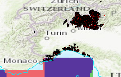

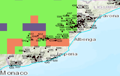

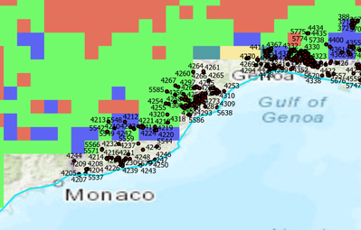

These were great suggestions.  I was unaware of them and they seemed as though they would do exactly as I wanted... which is to stretch my raster out...to the borders of the continents ... where I could then do an extract of those values to my points.   I tried both tools with various options, unfortunately neither of them provided additional raster values out to the border areas of interest.  It is the colored raster that I am trying to extend to the continental borders (blue line) so that I can subsequently perform an "Extract Values to Points" to get the values from the raster assigned to the points (red dots).  The 'nibble' and the 'euclidean allocation' resulted in the same raster boundaries as the original.  The 1st image provided is my original data.  The 2nd image is the Euclidean Alloc - which assigns values OUTSIDE of my continental boundaries.  The 3rd image is the result of "nibble" which is essentially the same coverage as the original input.
