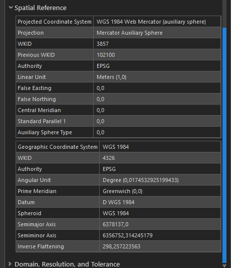

After checking the properties I found multiple Spatial refecences:

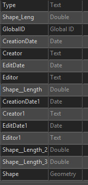

I didn't know this was possible. Looking at the fields I see a small mess:
 4 shape length fields, hmm. Some of the data is collected using Collector, other might have been copied using Pro.

@Gisbert61the second coordinate system you see listed there is the geographic datum.  Each projected coordinate system will have a geographic datum.  So, this is normal what you're seeing.
The multiple shape_length fields your seeing are most likely from multiple copy/pastes or export/imports.  Only one will be updated, and you should not be able to delete this field (if the data is residing in a geodatabase).  The other shape_length fields should be able to be deleted.
