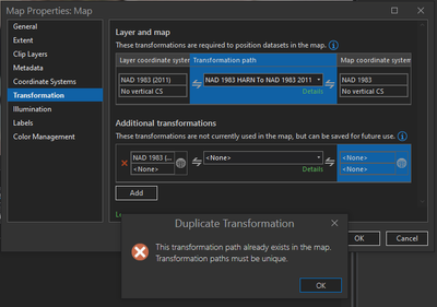

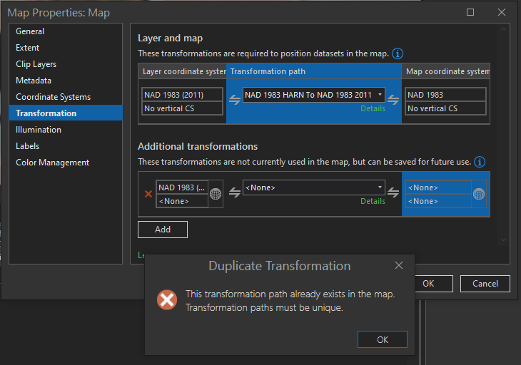

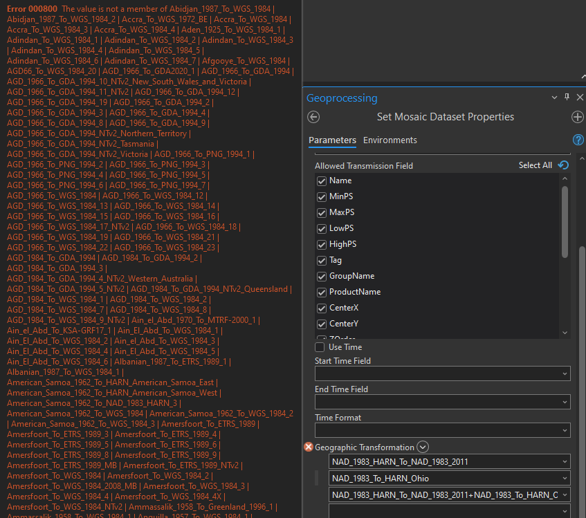

We are creating a set of source Mosaic Datasets based on the imagery year and many need different transformations applied.   These will be combined into a reference dataset to be published.
1) I have some data that needs to have a combination transformation applied (NAD_1983_HARN_To_NAD_1983_2011 + NAD_1983_To_HARN_Ohio).  When building the mosaic I can only specify the individual transformations listed and not the combination.  Is there a means to do this when building the dataset?  Error 000800 the value is not a member of... is received for the combination transformation.
2) In ArcGIS Pro 3.0, is there s means to apply a transformation by layer rather than to the map?  The map only allows one transformation per group.  For example between NAS 1983 (2011) and NAD 1983 I have some data that needs the NAD_1983_HARN_To_NAD_1983_2011 + NAD_1983_To_HARN_Ohio transformation and other that needs the WGS_1984(ITFR08)_To_NAD_1983_2011 + WGS_1984(ITFR08)_To_NAD_1983 transformation.
