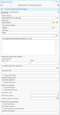

It is possible to be very controlling in how you create a mosaic dataset, but there are a lot of unintuitive things you have to be aware of and how they interact. It is, in general, not necessary for imagery mosaics from a single source.
I would suggest starting over from scratch with a new gdb and new empty mosaic dataset. You barely need to change any of the default options when creating a new empty mosaic dataset, just pick the right coordinate system you want to use. As long as all your tif's are from the same source and just have 3 bands, you don't even need to specify # of bands or pixel type.
Once the mosaic dataset is created, right click it and choose Add Rasters...
Specify the Input Data as 'Folder' and navigate to the proper folder with tiles
DO NOT create pyramids
DO NOT calculate statistics
Neither of these do anything constructive for us since we don't stretch image tiles -- we will be creating overviews instead of pyramids.
UPDATE OVERVIEWS option -- check that box!
That will basically put this on "easy mode" and streamline the entire overview generation process instead of manually setting up "define overview" and also manually running the "build overview" steps.
Try this basic workflow and see if you get proper results. You can then experiment with changing different aspects of the mosaic dataset if you feel that you need to, but often for imagery mosaic this should be good to go for general use. Don't forget to turn off default Stretch symbology settings for rasters (if so enabled) when you add the mosaic dataset to Pro.
