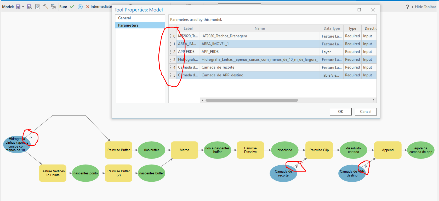

Hello. I have this modelbuilder I've been working on. I've set a few parameters in the past, but have since got rid of them. But, for some reason, they still show up on the properties window and on the geoprocessing pane when I run the model. Please see the picture below. There are 6 parameters on the properties window, but only 3 on the model. I've already run "auto layout", but that's it. There are only 3 parameters, but ArcGIS Pro insists there are more.
The worst part is that I can't do anything about the ghost parameters. Can't delete, can't rename. The layers they reference don't even exist anymore. What can be done?

Something to try is in your ArcGIS Pro project (or a new project), create a new ArcGIS Pro toolbox, copy the model from the original toolbox and paste it in the new toolbox.  Open the model in edit mode, and on the ModelBuilder tab in the Run group, click Validate, then save.  Then go to Tool Properties:  Model and see if the ghost parameters are still there.

TahaEzzy
Hi Robert,
I was having the same issue as @jbcypreste and the problem seems to be fixed!
Thanks a lot!
