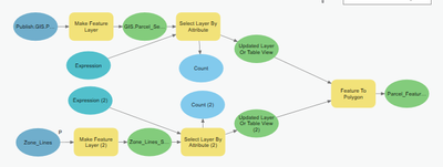

Attached is a screenshot of my model. As you can see, I have two select by attribute tools in this model. For it to run, the user will have to select from 79 Areas(Called Z-Areas in my organization) in both select by attribute tools. I would to make it so that the user will only have to make one input instead of having to open each Select Layer tool and make the selection. Is this possible?
Thanks

Are Expression and Expression(2) different? If they are the same, you can connect the same variable to both Select Layer by Attribute tools.
Whether they are the same or different, make them parameters and run the model as a tool.
JustinBernard1886
Oh perfect! Setting the parameters and running the model as a geoprocessing tool worked perfect.
