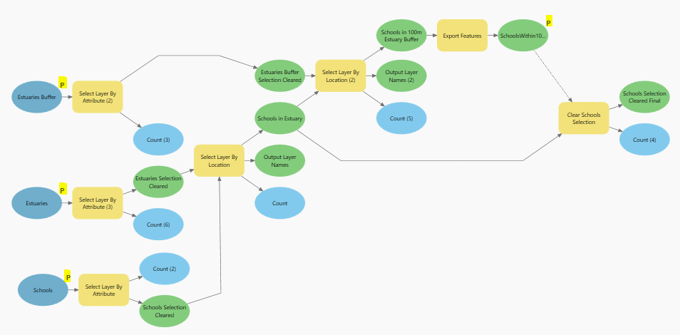

Here is the new model with 3 input parameters and 1 output parameter:

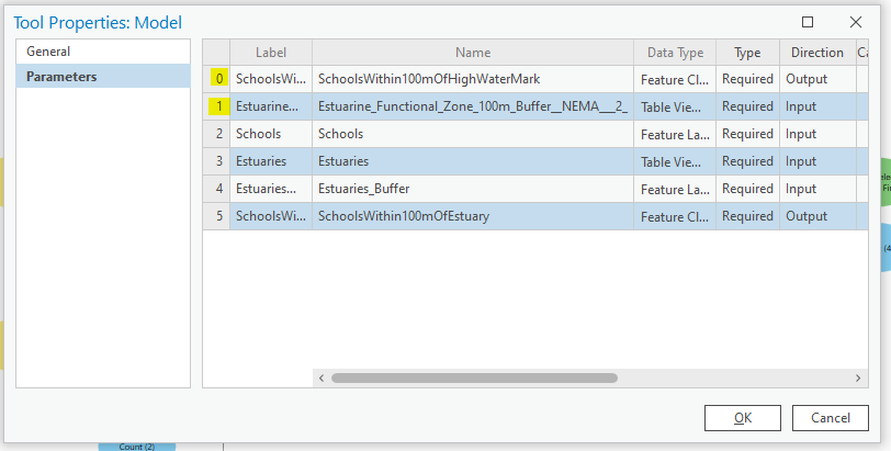

But in the Parameters window I have 6 parameters of which the first two are no longer in the model. None of the parameter information is editable in this window and from what I understand some of the properties should be editable. The only thing I can change is the order of appearance of the parameters.
How can I get rid of these two parameters?

In your first image where the model exists, can you right click on the input and/or intermediate datasets and click the left click the model parameter item which has a green checkmark to the left of the word parameter.  Do this for all the datasets to not have parameters.  Save your model.  Do you then see those same model parameters in the model properties?

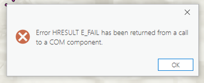

I have the same problem. When I try to delete the parameter from the Tool Properties window (via delete on the keyboard) I get the error below and the parameter returns.
Thanks, Steve
