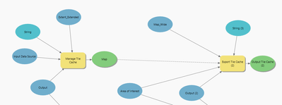

I am trying to build a model to first run Manage Tile Cache, then take the result and run Export Tile Cache on it.
But model builder doesn't seem to like it.
Manage Tile Cache creates the green Map node, but it doesn't plug in nicely to Export Tile Cache. (because it doesn't in fact exist yet?)
CarsonMorton
I don't know if this is the best way to do this, but it works.
I have to use a map (Map_Wide is what mine is named below) as the input tile cache... note that this map must already have had its tile cache managed.
and the output 'map' from manage tile cache is used as a precondition for the export tile cache tool.

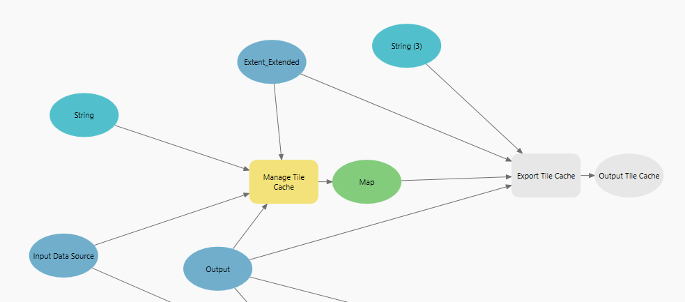

CarsonMorton
