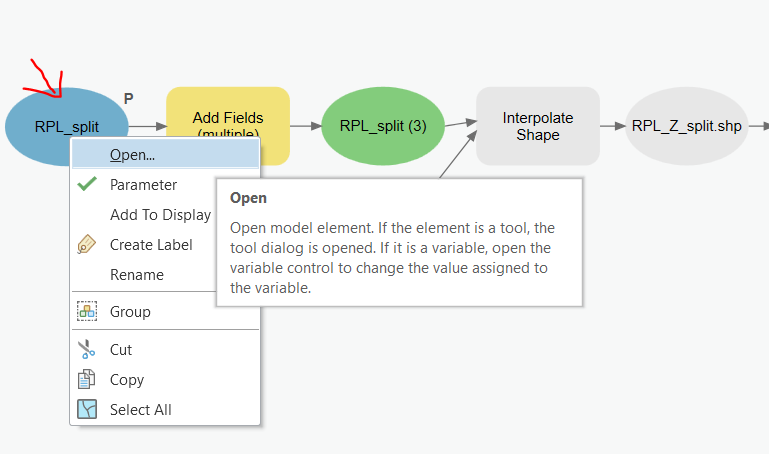

I have a toolbox with a single tool inside.
Whenever I try to edit a parameter or run the tool, ArcGIS Pro crashes.
The toolbox and the tool were produced using a previous (recent) version of ArcGIS Pro and used to work with no issues. Unfortunately I cannot remember the exact version, but it's recent as I have automatic check for updates enabled and I update whenever I am notified.
I attach the toolbox for giving anyone interested the chance to replicate the problem and possibly diving into it a bit.
I also attach the dump file produced on the last crash.
Here are the steps to reproduce the crash:
- open my tool in edit
- enter with double click in whatever parameter
- makes some legitimate change (e.g. change the source file to another)
- click OK to exit the window
ArcGIS Pro should come back to the edit window. However, the application crashes.
The same happens when I press RUN to execute the tool.
Is this a bug?
Any help would be very much appreciated.
I'll also open a support ticket if you think it's better.
Thanks in advance.

Hi Alessandro Valra,
Thanks for reporting the crash. I will check and get back to you in a day. Could be a tool related issue.
ShitijMehta
I can reproduce the crash and we have added it to our backlog to fix it for the upcoming release. Thanks again for reporting!
