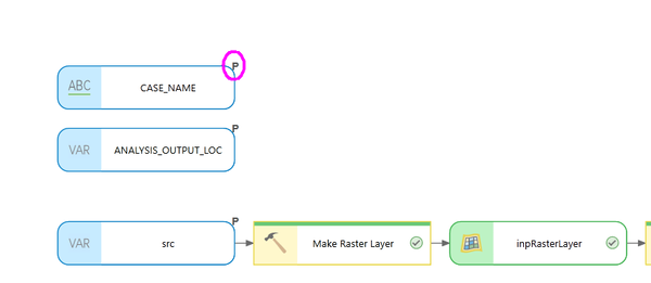

Oh, and with everything changed to look nice, why does the P still stick out on the corner to indicate a parameter?
I can think of a few aesthetically pleasing yet functional ways to show the same.

Interesting with those P:s (or is it little flags?). I dont see them in my UI at all.

ModelBuilder vocabulary—ArcGIS Pro | Documentation
way down at the bottom, they are modelbuilder "Parameters" (that is, the dialog will enable you to change/select from options if parameters are set)
