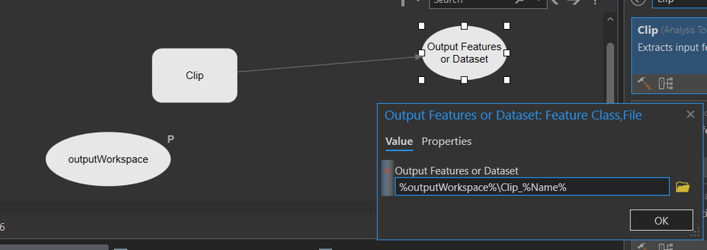

Hello @AF2023,
I think you can easily accomplish it creating a variable (workspace type). Then set this variable as parameter to allow users to choose the right output. Finally you just need to change the Clip%Name% to %variableName%\Clip%Name%.
Hope that helps!

AF2023
Brilliant - thank you!
