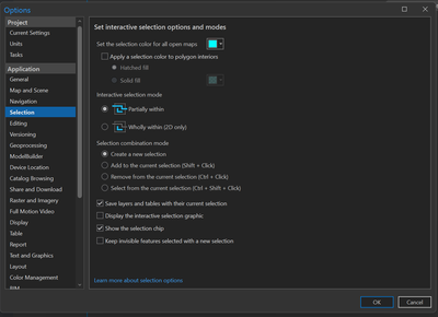

Eugene_Adkins
An idea ... check the selection settings of your aprx (project tab/options). See if the "Interactive selection mode" is set to "Partially within." This may have nothing to with the issue since closing the aprx "fixes" the issue. When the issue happens, you could also attempt to select the features using the lasso or the polygon selection option to see if the selection issue is consistent.
