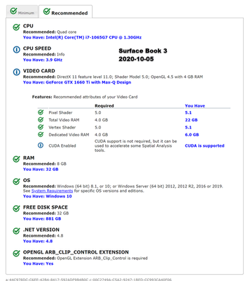

DanPatterson
MVP Esteemed Contributor
I have used Surface Books since V1.
It has 2 graphics devices.  When you are using it in laptop mode and one for tablet mode.
Tablet is fine, but novelty of splitting the Surface in two soon wore thin.  I have used it in laptop mode since.
They are great machines but if you don't need the tablet, then you could probably look at other Surface options to save some change, but whatever you do, get the full ram option
This is the Can you run it results for Pro

JeremyWright
Just gonna chime in here and note that Surface NOTEBOOK that Dan provided specs for above is different from the "Surface PRO" series - it  actually does have a discrete GPU (GTX1660Ti).
The latest Surface Pro (Surface Pro 😎 contains 11th-generation Intel Core processors, which have an upgraded integrated GPU called the Intel Iris Xe, which does provide better performance vs. previous integrated GPUs.
Anecdotally: I have a machine (not a Surface Pro) that contains Intel Iris Xe GPU as one of my daily driver machines (working on developing ArcGIS Pro) and in testing it performs admirably for an integrated GPU, but without dedicated video memory you are going to want to configure your system with MORE system memory - because the integrated GPU takes system memory to use as video memory.  That means potentially getting the top-end config Surface Pro - which has 32GB memory.
Just my 2c!  FWIW when we were first developing ArcGIS Pro 1.0, my daily driver was an original Surface Pro, and it worked OK.
One last thing to note: if you want to use Deep Learning tools, those require CUDA acceleration, which is only available in NVIDIA GPUs.  This requirement is enumerated in https://pro.arcgis.com/en/pro-app/latest/get-started/arcgis-pro-system-requirements.htm
