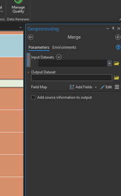

Laura
by MVP Regular Contributor
Is this the tool?
What version enterprise?
