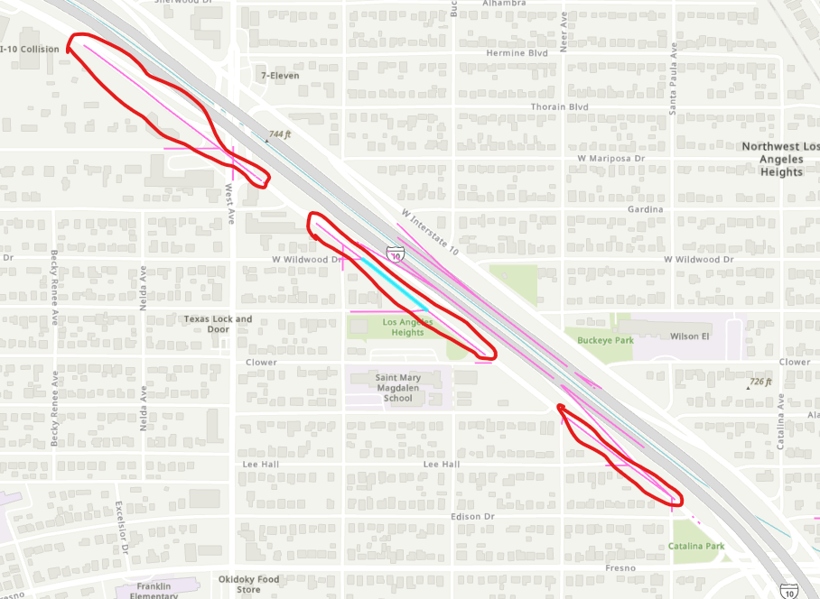

For example, in the photo below, I would like to merge each of the 3 frontage road areas circled in red into 3 groups. In each group, there are currently multiple segments of frontage road (blue is selected, pink is unselected). I do not want to merge the feeder roads into the frontage road segment.

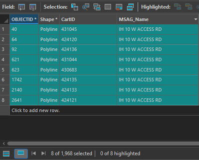

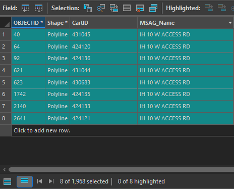

Here is the attribute table with all the frontage road segments selected:

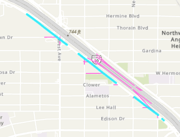

And here are the selected frontage road segments:

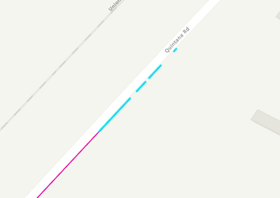

This did not solve my issue, I need to be able to merge features together within a certain distance, not just features touching vertices.
The three blue lines are within about 10 ft from one another, I would want all four of those segments to be included with the pink line feature.
