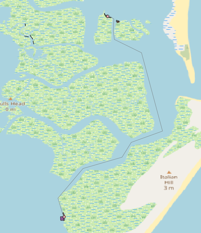

I want to do something like I've illustrated below. I have drawn a line between two points across the water, moving through islands. The screen shot is just an example but you get the idea.

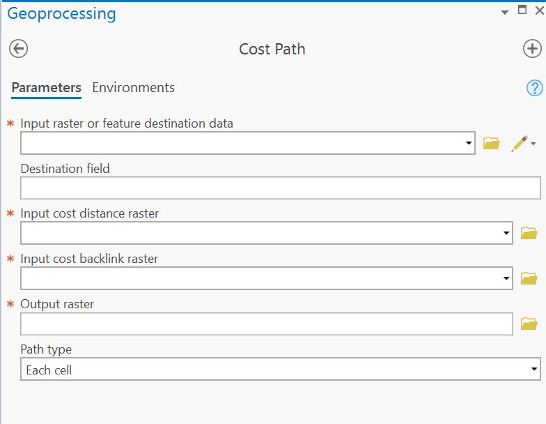

I think I don't understand the least-cost path tool in ArcGIS Pro
I've read the docs for this tool. A couple things I fundamentally don't understand are...
-There is an input field for the destination data, but how about the starting point?  How does this know what to measure between?  (I have many points)
-What is the input cost backlink raster?

The cost path is normally one of the last tools you use in a sequence of tool to get the result. You will have to use the Cost Distance tool (that uses the origin) to generate the cost distance raster and back link raster which are needed in the cost path tool.  In ArcGIS Pro 2.5 (to be released February 3rd) there will be better and enhanced tools to do this more easily.

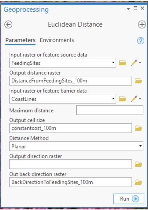

at 10.7.1 and 2.4, you can use enhancements to the euclidean distance tools to accomplish this. Please see this blog post.

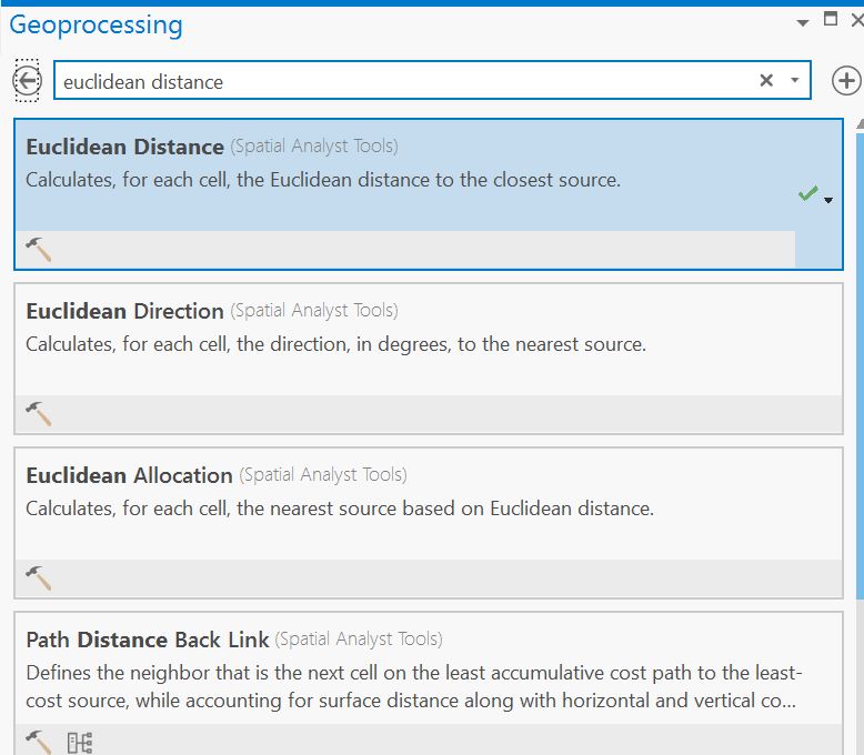

Thank you for the link to the blog post Jim Tenbrink‌. This looks like exactly what I want to do. However, it appears I do not have the same Euclidean Distance tool as you do in the article.  Also, I have verified that I am using ArcGIS Pro 2.4 (also have 10.7 available).
Your Euclidean Distance tool looks like this:
While mine looks like this (I'm searching for it as I would any other geoprocessing tool):
As you can see I do not have fields for 'input raster or feature barrier data', 'out back direction raster', and so on.
Am I missing something really obvious here?

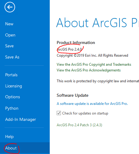

I've installed 2.4 and verified the new parameters are there. On your machine's install of Pro, under Project Tab`About, please double check the version of pro you're at:
Regards,
-jt
ErichPurpur1

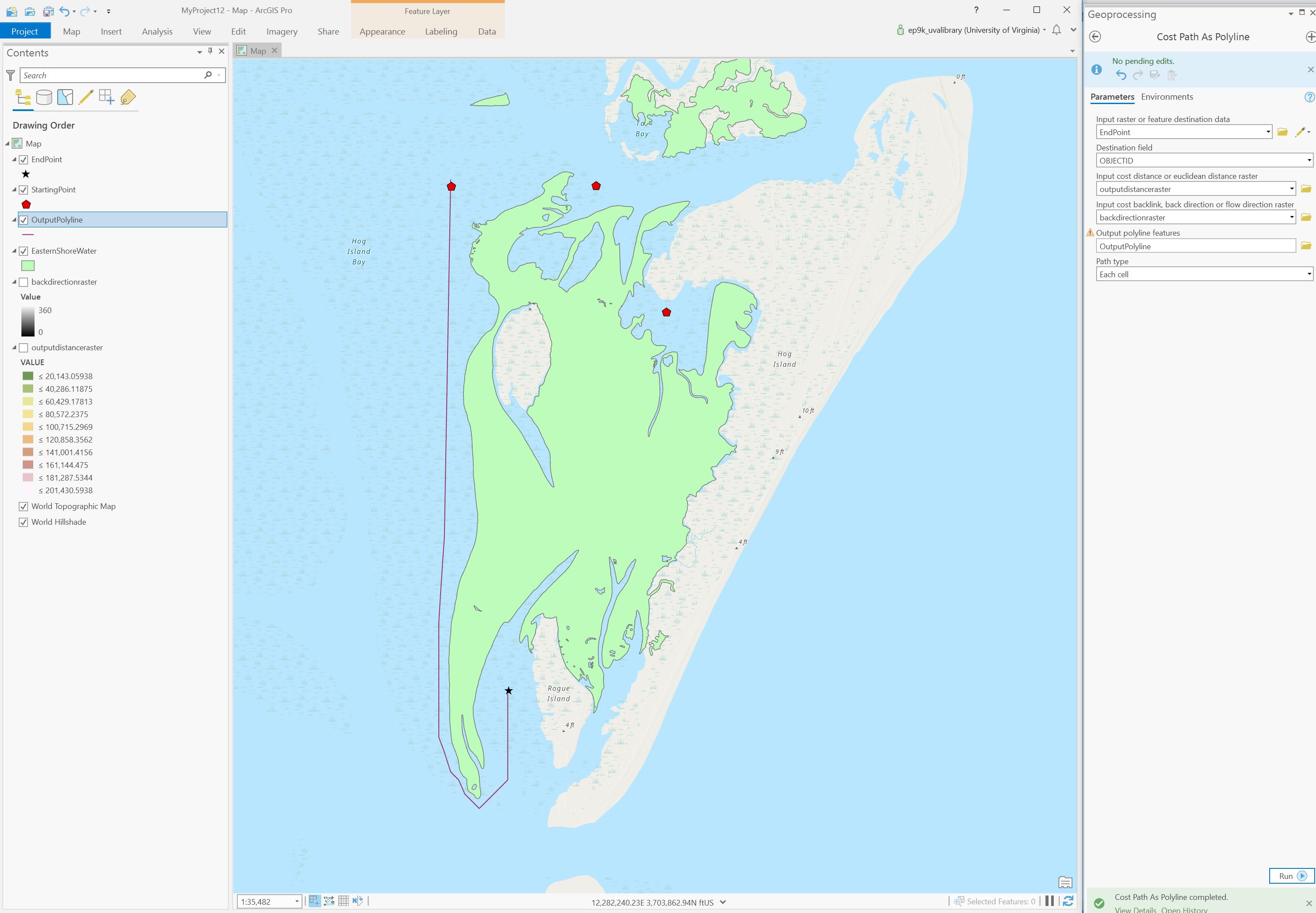

Thank you Jim Tenbrink‌ I was at version 2.4.0 but upgraded to 2.4.3 and it works now. The process works, except I am getting a polyline result for just one 'starting point'. I have multiple start points and one destination. After reading the documentation for the cost path as polyline tool, it is unclear to me if the output can be more than one line. It is a polyline object so multiple lines as output should be possible...
Here is an example screenshot of my output polyline and parameters for the cost path as polyline tool. As you can see I just have the one polyline as a result:

Erich:
For the "source" parameter of Euclidean Distance, you need to specify the "EndPoint" feature class and for the "input_raster_or_feature_destination_data" parameter fo Cost Path As Polyline, you need to specify the "StartingPoint" feature class. One polyline feature will then be emitted into the output feature class for each DATA cell in the StartingPoint feature class.
Also, once you get the process debugged and working ok, you might want to increase the resolution (decrease the cell size) of the process.
