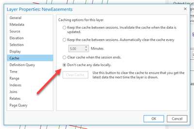

RhettZufelt
MVP Notable Contributor
what about tuning caching off for the layer?
R_
