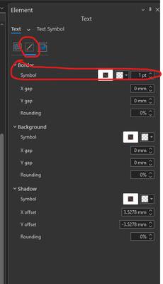

You can create a border around the element pane easily enough by going to the element properties, selecting the Display tab and then setting a border:

Ah, so add another element frame in the same location and symbolize that one while leaving all the borders off the legend element.
Not elegant, but it works!
