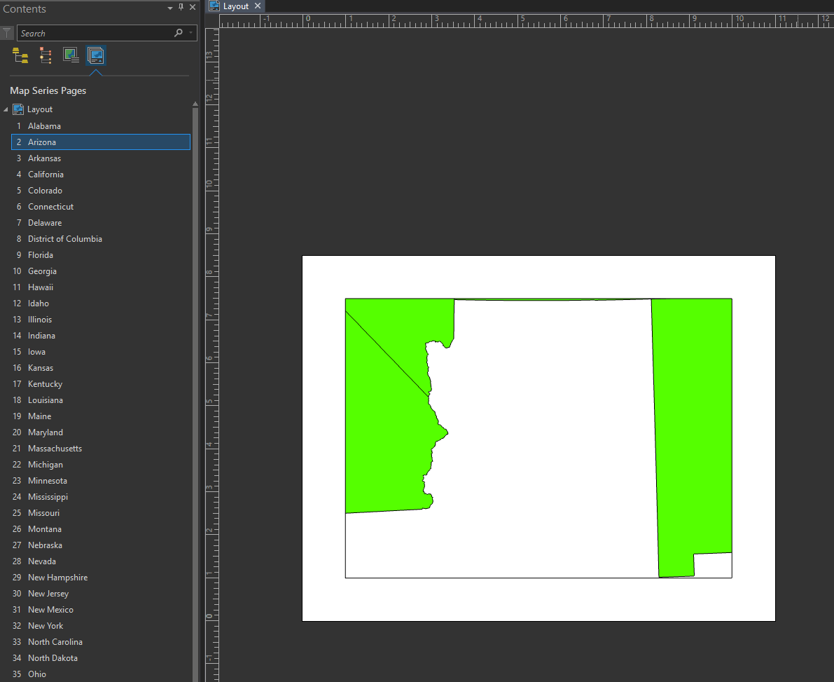

Cannot for the life of me figure out how to make page specific projections work in Map Series without refreshing between each and every map.
Simple example: using US states projected to NAD 1983 HARN as the feature layer for Map Series, file path in attribute table pointing to projection from each feature (all US state planes in HARN -- see attachment image) and it frames the features just.... really terribly.  Doesn't matter if it's during the auto-export to PDF or if its by visiting the page in the layout.
Arizona doesn
HOWEVER, if you refresh the entire map series between viewing each page, the map is framed perfectly and in the proper projection.

Hi ronaldotortugas‌ I see what you're describing when I work with the data.
We've looked at this with our layout team, and they have entered it as an issue to fix.
Sorry for the inconvenience and thank you for bringing this to our attention.  We'll get it fixed!
