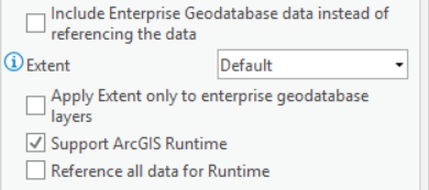

Getting "Failed to create service lakes MapServer. Service failed to initialize: The map package is not supported by the ArcGIS Runtime. There is no .msd file available inside the package. Check that it was authored with ArcGIS Runtime support enabled." error when loading mpkx from ArcGIS runtime SDK app using local server. Map has data from enterprise database and I want to reference the data instead of copying it to FileGDB so I choose the following options when creating map package.
When I extracted .mpkx file, I don't see msd file in the package. I am using ArcGIS Pro 2.3 and Runtime SDK 100.4.
