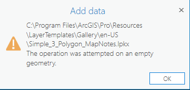

Map Notes Error message "The operation was attempted on empty geometry"
1443
09-30-2019 06:46 AM
StevenHeadley
When I attempt to add a polygon with map notes (Insert Tab-Layer Templates) I get the message C:\Program Files\ArcGIS\Pro\Resources\LayerTemplates\Gallery\en-US\Simple_3_Polygon_MapNotes.lpkx.  The operateion was attmpted on empty geometry.
I can navigate to that layer package.  It opens and I can use Map Notes in that project, but not in my current one.
