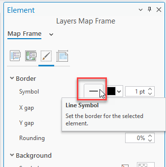

TashaLowrey
I did do that, but it won't let me change it from a solid line.  Before I had the choice of difference border selections.  I just tried it again.  I can change still change the Background, Shadow but the Border will only let me have a solid line, I can change color or size but not style.  Before in ArcMap I had border frame choices.
Thank you for replying to my help note.

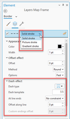

AubriOtis
Hi! To change the border line style first click the line preview for the border. This launches the full style editing experience.
Then you can play with thickness, dashes, stroke type, and more.
