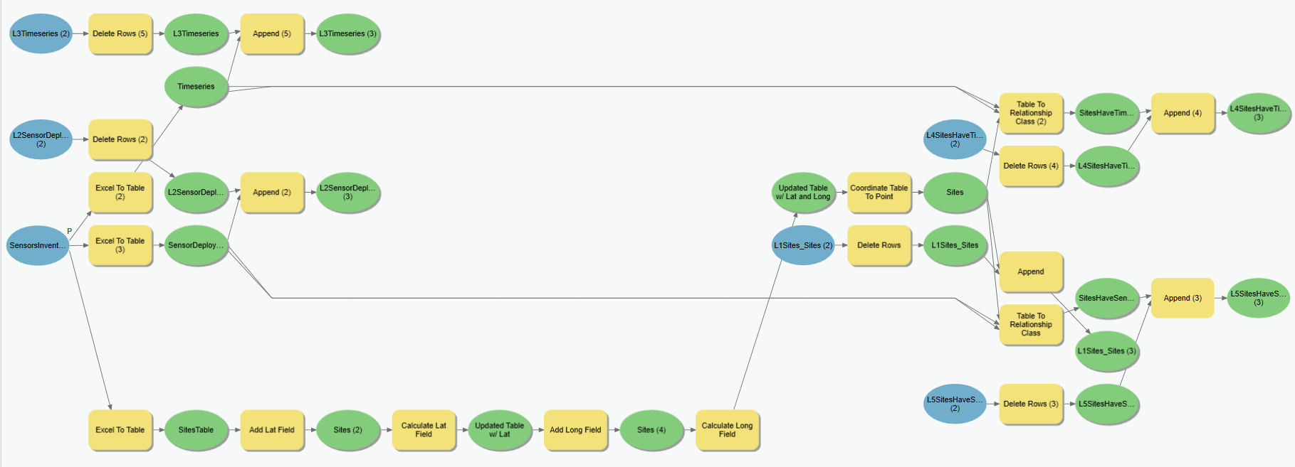

Here's a pic of my model (hopefully it's not too small):

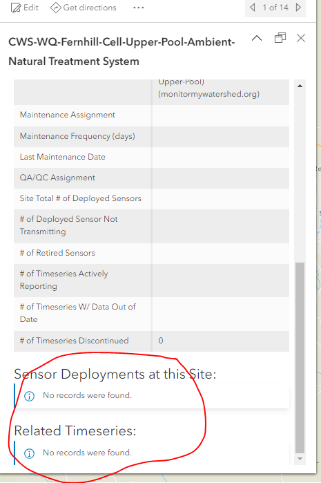

Pop-up window:

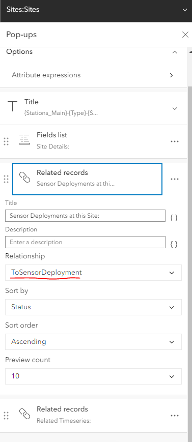

Pop-up settings window:
