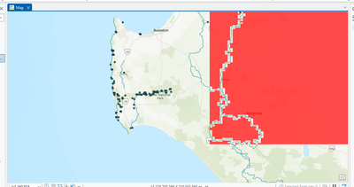

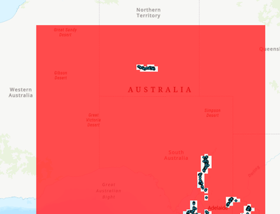

Does anyone know why my project would show this map glitch after updating to the latest version 3.4? It's not always red, sometimes it's white. When I pan around or zoom the glitches appear randomly.

Hey @Hels77
This looks something like this issue here: https://community.esri.com/t5/arcgis-pro-questions/graphical-glitches-within-map-window/m-p/1561788#...
The recommendation was to update your graphics drivers and attempt to "switch in the Display tab of the application options menu from DirectX12 (which is the default in 3.4) to DirectX11 (which was the default in 3.3). You can also try OpenGL."
The resolution was due to the machine not having a dedicated graphics card I believe.

Hels77
thanks heaps Cody
