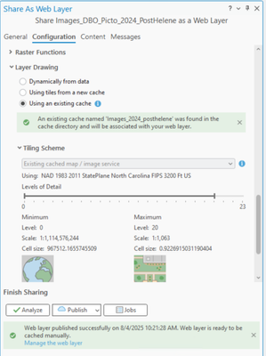

I figured out you need to set the scales and cache preference when you are first publishing the web layer in Pro.

I delete the cache directory and started over.   Then I published the mapservice with Pro and set the caching in Pro and then it recognized all the scales. What version of Pro are you using?

Yes, that just worked for me too.  It looks like the bug is associated with the caching tools.
