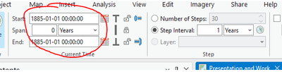

Axelvon_Matern
I have the same issue. I figured out it appears AFTER I made an animation. Even if I delete the anmination the issue persists. Havent updated yet to the latest ArcGIS Pro tho....
Axelvon_Matern
I found out that the time settings is changed when creating a new animation. I found that the little lock symbol was set to unlocked and that the start year was set to somehting like in a couple of months into the year. That was the culprit on my issues.
