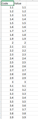

KimberlyGarbade
Did it work with so many values?... It worked when I tested it on 20 or so values, but I've never created a domain that long before.... an image of the Excel I saved as .csv and imported is below.
