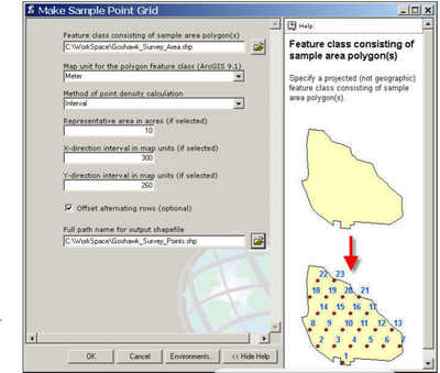

DustinCahoon
I think it is a custom tool. Documentation that I have says: MakeSamplePointGrid.py is a Python script tool that creates a systematic grid of points within user-specified polygon features. Users
control point density by specifying a representative area for each point, or by specifying X and Y point intervals. Can choose to offset alternating rows.

Hi Johannes. I was told to reach out to you since you helped Dustin update the tool to run in Pro. It worked for me. And then I didnt need to use it for a little while. But when I went into try to create a gri, it gave me an error which I will post below. I specifically use this tool because it is the only one that offsets the rows which is needed for creating our goshawk grid call stations. Do you know if Pro updated and the older version no longer works because of that? Do you know how to fix it? Thanks. See error below:
Make Sample Point Grid
Parameters
Feature class consisting of sample area polygon(s)     T:\FS\NFS\ApacheSitgreaves\Program\2600Wildlife\GIS\SO\Workspace\ndouglas\Projects\BM\Nagel\Dutch\Dutch Rx NOGO Inventory\DutchRx_NOGO_InventoryArea.shp
Method of point density calculation     Interval
Representative area in acres     10
X-direction interval in map units     300
Y-direction interval in map units     260
Offset alternating rows     true
Output Feature Class     T:\FS\NFS\ApacheSitgreaves\Program\2600Wildlife\GIS\SO\Workspace\ndouglas\Projects\BM\Nagel\Dutch\Dutch Rx NOGO Inventory\DutchRxNOGOInventory_Grid1.shp
Environments
Output Coordinate System     PROJCS["NAD_1983_UTM_Zone_12N",GEOGCS["GCS_North_American_1983",DATUM["D_North_American_1983",SPHEROID["GRS_1980",6378137.0,298.257222101]],PRIMEM["Greenwich",0.0],UNIT["Degree",0.0174532925199433]],PROJECTION["Transverse_Mercator"],PARAMETER["False_Easting",500000.0],PARAMETER["False_Northing",0.0],PARAMETER["Central_Meridian",-111.0],PARAMETER["Scale_Factor",0.9996],PARAMETER["Latitude_Of_Origin",0.0],UNIT["Meter",1.0]]
