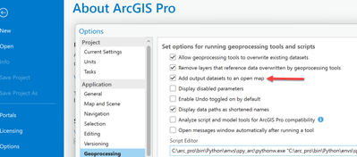

check your geoprocessing options in the Project backstage to ensure that results are added to the active map.
... sort of retired...
ToyotaT18
Yep that's already ticked on
