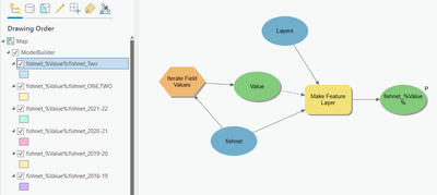

If I run Make Feature Layer as a tool, the new layer is added to my map. If I put the tool in a model and run the model ('Add to Display' is selected), The layer never appears.
If I open the model and run it, the layer is added to the map, but they are in an awkward group called 'ModelBuilder' and have a prefix I don't want them to have.

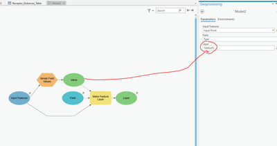

Please set the output as a Model Parameter as well.
As per Run a model
Note:
After the model tool runs successfully, only model outputs set as model parameters are added to the map.

Like this?
Doesn't work :(. I did remove the iterator and the one output layer was added, so I think I've hit a snag with the iterator. Thank you very much for your help here!

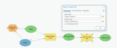

I added a 'Save to Layer File' tool and that does create a *.lyrx file for each unique value. The model will not add those into the map either, but it does create something I can see and work with after the model has run.
Loading feature layers created within a model or a script into the TOC has always been difficult. I have an old python script that does it and it's got a LOT of steps.

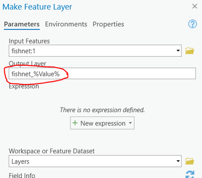

Don't rename the Value. Rename the output layer in Make Feature Layer tool.
Think Location
RandyMcGregor3

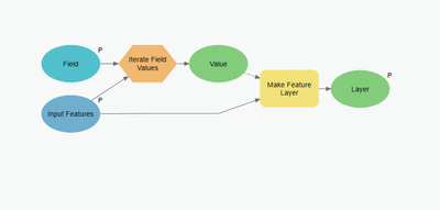

I appreciate your willingness to work through this. This is pretty much what I have been doing. I can get them to add to the TOC from within model in a 'ModelBuilder' group like you show here, when I open the model and run it, but not when run as a tool.
RandyMcGregor3
If I run the iterator first, so that it is 'stuck' on the final value it calculated and only processes that one, it will add the inputs to the map. If I reset the iterator so that it cycles through all the values, it will not add the layers to the map.
