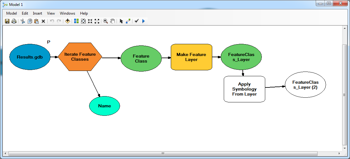

It's like LR mentioned above, ModelBuilder only allows one iterator. To use another iteration you have to build another model and integrate them together by dragging and dropping one model into the other. In my case, I made the first model output a precondition to the second model.
Looks like you already figured out the second iterator. It seems that Apply Symbology From Layer works if you add a step to make sure that the input is a layer file. (Mine is not valid because I don't have a symbology layer put in)

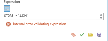

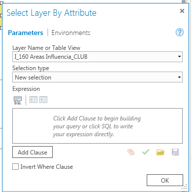

Now the question is what are your parameters for Selecting Layer by attribute? I can't seem to create the expression based on the STORE attribute
it seems that I can't build an expression as it has no input until it runs....
LR
Right-click "Select Layer By Attribute" --> Make Variable --> From Parameter --> Expression. Then mark the expression bubble as parameter. This should give you an expression field when you run your model. The query builder should be populated with your selected data's attribute fields.
HectorBorro1
Deactivated User
I found that when doing an iteration by rows there is no need to select by attributes as the attribute I'm interested in selecting is the one that is being itereated, so it is a duplicate process and can be removed...
