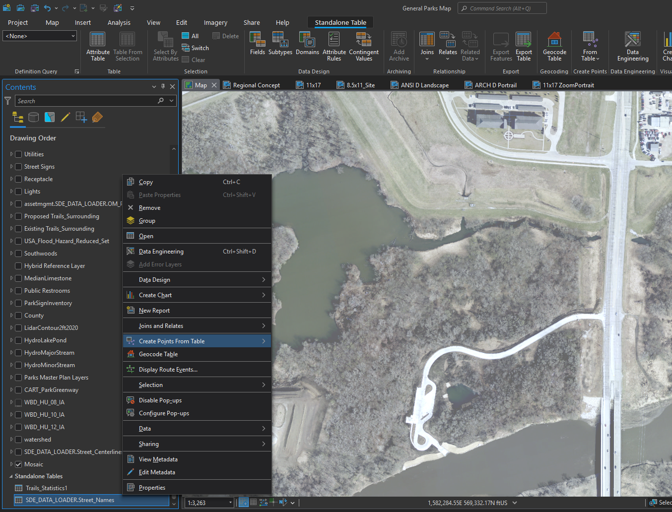

Hi.
I am using ArcGIS Pro 3.3.6 and the municipality I work for has an Enterprise Geodatabase Table for every street name in the City. I would like to have these street names labeled and displayed on my map and I just don't understand how to do that. It would be a bonus if I could change the font and size and stuff once i get it displayed.
It seems so easy, and i've researched a few different areas and watched a couple of videos online, but I just cannot figure it out.
I would greatly appreciate any help/insight as how I can achieve this.

It would need to know where to put the labels and a standalone table doesn't have a spatial component.
You will want to label the Streets Centerline layer instead.  If it doesn't include the street names in the table, but has a common ID between it and the table, you would want to join the standalone table to the Centerlines, then you would turn on and configure labeling for the Centerlines layer.
Then, when you toggle on the Centerline featureclass, it will show the labels.
