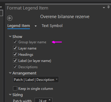

I have a ArcGIS Pro 2.5 map in which legend items (group layer name, layer name, etc.) are locked. They are checked but grayed out. See attached snips.
I have tried deleting the legend and creating a new one. I have tried creating a new layout. I have tried removing layers and re-importing them from the database. I have re-started the application. None of these has solved the issue.

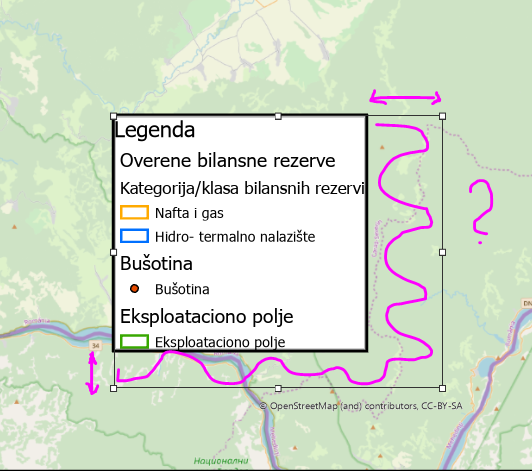

When we are speaking of legends, please, could anybody shed a light in the matter of size of legend? Why on earth when I resize legend, the frame with grips gets at some point off the legend? For what purpose could that be good? How could one control that? I am completely stunned.

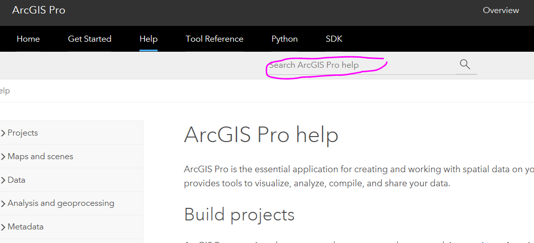

And than, to say the very last frustrating point in the whole story today, please does anybode has a clue why I get no result after search in ArcGIS Pro online Help?
For example, I go to the first page of online help

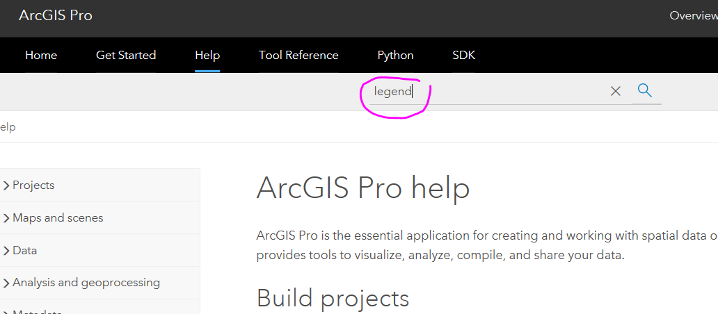

and enter my search word "legend". This word should be in that help text by any means, isn't it?
I hit search button and get as follows
I should try again later??? Very, very fine stuff, thank you ESRI for the help.

I get the "try again later" on occasion.  I simply hit enter again and it usually works on the second try.  I appears it times out when the search term is too broad and many items are being returned.  In the case of legend, it says About 113 results (page 1 of 😎

Unfortunately, I cannot help you without knowing the details of your scenario. I assume that you read through my example in a thread above and have tried to toggle the visibility of a Group layer name by selecting and editing the properties of the top-most (in the legend item list) item. If this is failing then this is a bug and should be reported to support (https://support.esri.com/en/contact-tech-support).
We are aware that there is a bug when trying to toggle the Group layer name at once this by selecting and editing ALL legend items at once (see BUG-000128688). We are working to address this issue.

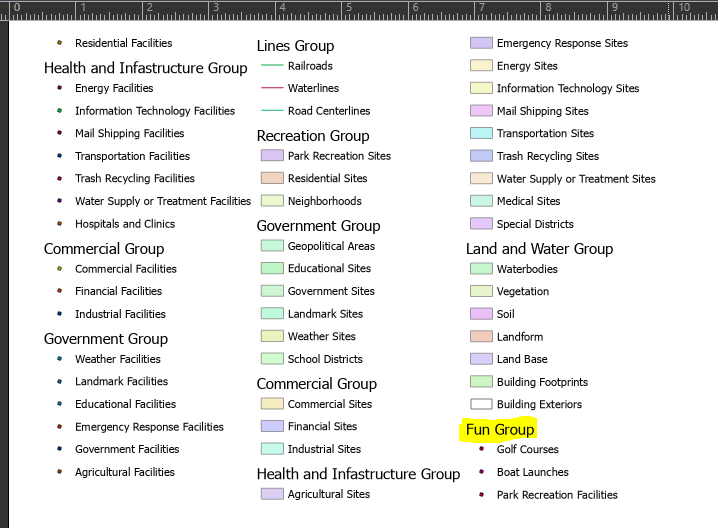

Once you understand that the visibility of the Group layer name is controlled by the group member that is top-most in the Legend list (Contents pane) you should be able to toggle Group layer name visibility.  For very large legends, I would recommend using Search in the contents pane.
1. Looking at the legend on the layout page, identify the Group layer name you want to remove. In this example I want to remove the group layer name "Fun Group".
2. "Golf Courses" is the first legend item under this group. It controls the Group layer name visibility. Since I have a lot of items I use Search to get to it quickly. Note: For best results search all, do not filter.
3. I open properties for the Golf Courses legend item and toggle the Group layer name visibility.
The Group Layer name "Fun Group" no longer displays.
We understand that this is not the best user experience and hope to improve this in a future release.
The mismatch between apparent legend size and it's bounding box
When you draw a box to insert a legend the selection bounding box represents the current potential space for the legend as defined by the box you created.
Legends can be dynamic. That is, content can automatically be removed or added to a legend. For example a legend with Layer visibility and New layer checked (see below) will adjust layers are turned on/off in the map or as new layers are added to the map.
As new layers become visible, or added to the map, their corresponding legend items are added to the legend.  The legend will automatically grow until it reaches the limits of the bounding box you specified.  When the legend has no more space for items you'll see the red dots indicating an overflow. You can then make the legend larger to fit all necessary items.

  • You showed really big legend, my friend! I have just a small one, with three items and don't need no search to find out which is the top most. But, still, I don't have the possibility to change status of it (as you said, this legend item controls the Group layer visibility of others), this item also has just inactive check box! I have got no way to change that status anywhere, at least I haven't found it yet... So, all I can do is to wait for ESRI to solve this issue. Means, we are talking about six to eight years, judging on how long ESRI needed to implement Search and Replace in attribute table... Hopefully they didn't organise voting on this...
Though similar to BUG-000128688, this is probably a different bug. I have yet to run into a problem with selecting the top-most legend item and successfully toggling Group layer name visibility. As shown in my response to Dan Allison above, I too was using a very simple legend with just 3 items (layers). That doesn't mean there is not a bug. Just that we haven't seen it.
Perhaps the fix to BUG-000128688 also fixes other legend issues not specific to the scenario described in the bug, including yours, but it also might not. I believe you are running into a bug. However, until we have reproducible steps to see this particular bug for ourselves there is very little we can do to fix the issue.
