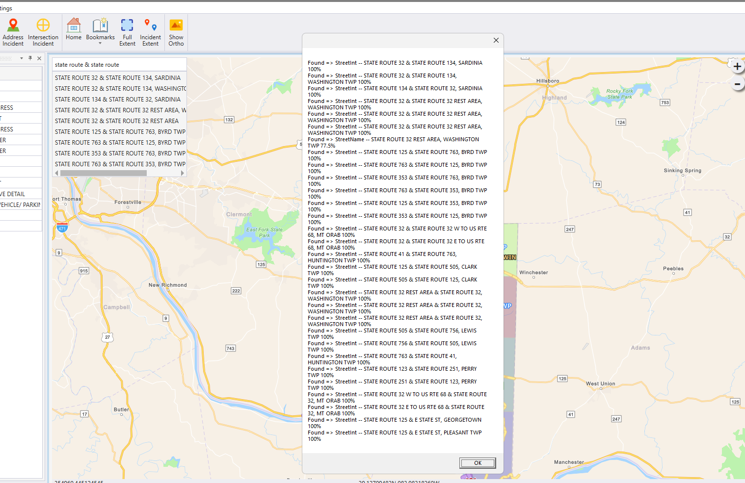

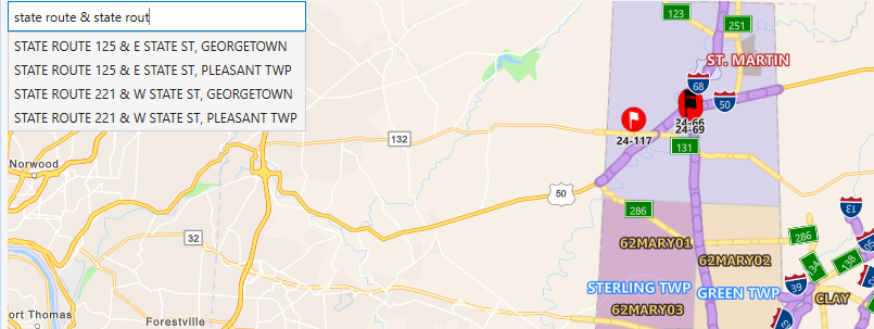

I have a locator built on a blend of county/city centerline/address point data for PSAP usage in validating locations.  Obviously, a county will have many intersections with a combination of STATE ROUTE ##/STATE ROUTE ##, US ROUTE ##/STATE ROUTE ##, CR ##/STATE ROUTE ##, and so on.  ArcGIS locators handle this pretty well, with the exception of the amount of text you have to enter to get a useable suggestion list.
If for instance I only type in STATE ROUTE & STATE ROUT, the locator seemingly ignores the "ROUT" at the end and only recommends STATE ROUTE & STATE intersections.  If I complete the word ROUTE...
I get many more suggestions and even beyond what I'm showing in the dropdown box.
